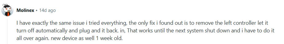

    thanks to reddit i discovered that the issue was actually software related not hardware
    this software problem was reported by a very small percentage of legion go owners
    some people even replaced the entire stick which fixed the problem for a while but then it came back later
    there was also the idea of creating custom settings for the dead zone

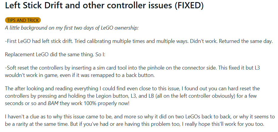

    a lot of people were sharing temporary fixes but i didn’t like that i just wanted to play not troubleshoot issues
    i tried going to the official service center but unfortunately i couldn’t replace the device
    i even considered buying a new controller to solve the problem but i found out that the issue comes back again after a while
    so clearly it was a software problem and the only way to fix it was from the device itself
    i tried doing a full system reset but the problem persisted
    after all that it turned out the issue was actually very simple
    the driver for the controller was installed twice
    so i uninstalled one of them restarted the device and everything started working perfectly
    it turned out to be a really trivial problem in the end
