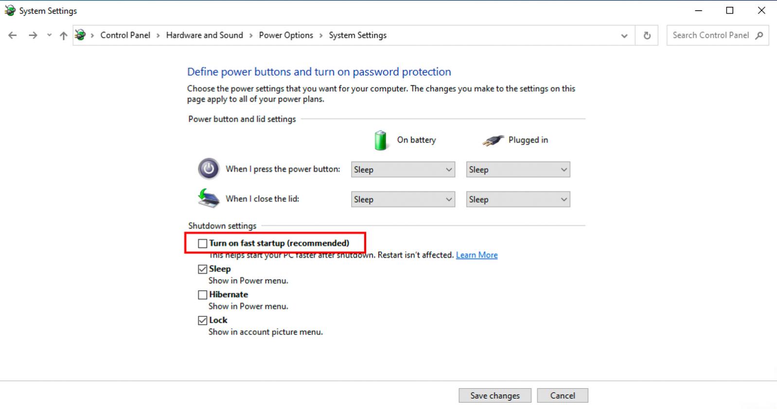

    @kojenci This is probably due to some driver recognition process failing to identify the USB device attached prior to Windows Startup.
    Can you try to disable the Fast Startup?
    To do this:
    1. Windows Key + R
    2. Write in the box "control" and you'll get into the Control Panel
    3. Go into "Power Options" and click in the left colum "Define power buttons ..."
    4. Disable "Turn on fast startup". Probably it will be greyed out, so in that case first click on "Change settings that are currently unavailable" just above the sliding settings.
    This is the Window you're looking for:

    Hi @Lascax! Thanks for the quick response!Unfortunatelly I've tried this and it did not help.I tried to turn off the USB selective suspend setting and the other checkboxes for USB hub in the Device manager too. I uninstalled the USB driver, reinstalled the AMD IO driver but no success.The keyboard does not work in any of the USB ports after startup till the reconnection (the mouse works), but with an USB-C hub it works flawlessly.
